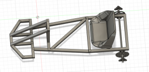

Hi,
I've remodeled a little bit de frame so there's some clearence between the frame and the tires as ONE-EYE said. I'll put some pics.
Does someone know which steering kit should I use because I can't find one with 20 inches 😅.

I see your trying to go with the rack n pinion setup but I'm not seeing where/how your looking to connect your A arms to the frame based on the design. The connectors that you're talking about are what goes into the spindle. The A arms connect to the frame (giving an up and down motion) and the spindles connect to the ends of the A arms (giving the side to side motion). The tires are mounted to the spindle. Those connectors are also connected to the spindle so when you turn the steering wheel, it turns both spindles simultaneously... and that's how you steer....Also if you're wanting front shocks, one end connects to the frame and the other to the A arm. This will provide suspension that you'll probably want unless you want to feel EVERYTHING LOL. I hope this helps a bit.

If you go with that steering setup in the pic above, you can just slapdash the tierods onto the rack and pinion for a measurement. The width from one of the ball joints to the other is how far apart the connection points on your spindle arms should be.
You can build out your frame to have the A-arms in place to mount the spindles right there. Big time and effort savings on the build.

My idea was to use the parts that are marked at the pic below as the A arms to put the spindles. And the other marked partsare the places were I'll put the spindles, and the question is that if the size of these parts is 15 cm (5,9 inches) will the tires touch the frame or I'll have to make these parts smaller so it doesn't touch?

You can adapt to fit as you acquire parts. Tire, rim, hub, and spindle makes a single rigid assembly. You can hold that assembly up to the kart frame, turning it as far right/left as you want the steering radius to be, and voila, that's where you mount the spindle.
