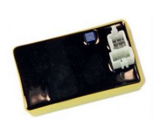

Here are some common components in a 250cc electrical box. Maybe this will help. Maybe consider both front and rear harnesses along with the parts shown to do a complete redo.
Karttekk
2,021
728
Elizabeth, PA
Taken from an AI paragraph.
"A resistor in a 250cc electrical box (often part of a CDI or ignition system) reduces current, limits voltage, or manages heat to protect sensitive components like LEDs, solenoids, or igniters from overheating and burning out. It ensures stable operation by managing electrical flow."
