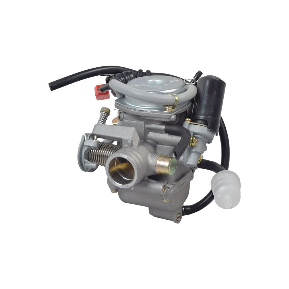

I bought this carburetor off of Amazon. I don’t know what this hole is for on the side of the carburetor

Look at some of these images, looks like a metal cap might be missing. Do you have the original carb? Check the hole in that one.
4,688
3,814
That pic got posted to face book 6 months ago.
Is it a blind hole or does it go somewhere.
It look like a metering screw would go in but none of the other images show that hole there.
Also those electric chokes can be troublesome. The black cylinder with the wires. I think they make a manual operation replacement.
If it doesn't match up with the original carb I would return it and get one that matches yours. That carb could be proprietary to a certain machine. I have 2 GY6 carb cores and neither one has that hole. If the original carb is still on the machine, try spaying a short blast of starting fluid in it then crank it. See if you get a sputter or pop from the ignition. Do a compression test too. Those engines eat piston rings and cylinders. They get hot and the cylinders wear. If you have weak compression you won't get enough vacuum to draw the mixture into the cylinder.
