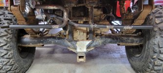

Modify exhaust or spend $300 on OE muffler
(most likely modify)
Modified
