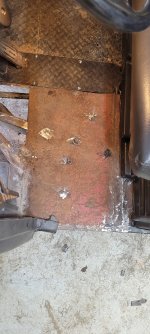

Half the divers floor pan done, will eventually do the passengers side, but it's not that bad so most likely I'll just do the front wedge.
eventually I'll have the means to go back and rip it all out and do it more "professionally" as in not use free scrap metal

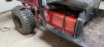

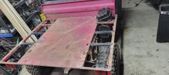

The worst of the bed floor is cut out, and the new frame braces/fender mount points are in.

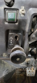

And holy hell this thing is quicker than I figured it for when tossed in High gear (2speed 4x4 with a manual rear locker)

•Replace the gas cap
•Replace the fuel gauge
•Replace fuel pump
•Replace radiator fan switch
•Replace thermostat
•Rebuild or replace carburetor rebuilt
•Replace all hydraulic brake lines
•Replace drivers floor panel support between main and side rail
•Resheet the cab floor (24x24 panels x2)
•Replace a few bed braces
•Resheet the bed floor (53×47 panel)
•Replace all 4 tires
•Replace the rear shocks
•Replace the front struts
•Replace R/R (passengers) parking brake cable
•Replace both rear light assemblies
•Replace the intake air filter hoses between the filter and carb, and the filter/roll bar connection
•Modify exhaust or spend $300 on OE muffler
(most likely modify)

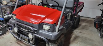

Not entirely sure how I feel about the new color... Kinda brighter than I expected 🚒
Now that it runs more reliably I will revisit exhaust mods. I may or may not just run it wide open pipes.

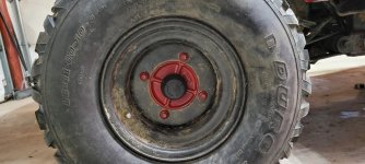

These 10x8.5 wheels with a 4/137 pattern wheels have been an absolute b★tch to try tracking down
1,298
Made a new discovery... there are wheel spacer adapters to change the lug pattern... 4/156 is common enough bolt pattern to get nicer wheels for cheaper.
Guess I'll look for cheap wheels I like and then see if I can match an adapter from there. I don't want gobs of tire hanging out from under, so I might need to be mindful of the wheel offset and account for a 1-1.25" spacing.
The current set are deep...5/3 and there's suspension clearance enough they could be flipped around.

Got the fuel pump in... Odd sucker though. It makes a fairly loud pop about once a second when it pressurizes the line at idle, can't hear it over the engine at full gait.
I'm sculpting a gauge cowl onto the hood for the 2inch gas gauge that's on the way.
1,298
That came out nice.
I would have made it easier and just recessed the gauge, but that matched the rest of the dash.
Couldn't recess because of latch mechanism, and theres nothing to mount to farther back. I set it back as far as possible.
The only other place I could have put it would have required a block off face plate for the storage bin it's mounted above.
I considered just putting a 2" hole in the edge, and mounting it into the hood instead of dash top, but that would have required making the electrical long enough to run all the way forward to the hinges and then back up to the gauge... wasn't really feeling like using an extra 6ft of wire.
