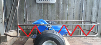

Next, I added a "crisscross" brace
...in the lower area of the roll bar
...behind the seat ;)
* I've seen this type of bracing in many race cars & off-roading vehicles
...& can "see" how it would make the structure stiffer & stronger :2guns:
It probably has an actual name
...so, if ya know...please share :thumbsup:
...& any info on its necessity &/or purpose too :cheers2:
Aligned & "held in place" with a weldin' magnet
After tackin' the first one "in place"
...I used a piece of steel strip, to help align the other tab
While I wasa at it, I went ahead & welded the front "stops", for the Nacelles, on too :thumbsup:
Used a weldin' apron, to protect the "stuff"
...down below the area, to be welded :cheers2:
