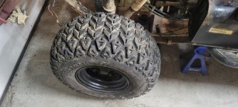

200yrds minimum and not a single knick in the rim 🤣
Such a shame for the tire though, it was new by all the whiskers on it

I love tying a band around a tire, dousing it with gas, giving it a roll, and flipping it over on a small puddle of spillage before lighting it up with a small torch 🤣1000001783.jpg

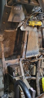

Got the screws drilled out of the central tunnel so I could further knock all the crap out and access the rest of the rotted out brake lines to the rear. I swear I've probably weight reduced this thing by 150lbs of rust and muck.
Front floor pans are Swiss mostly around the wheel well joint and especially the drivers side. This thing sat out in a field getting sun baked for at least the last 4 years, probably 5 but the battery is dated 2/19 so it's not been more than 5 since someone tried to make it run again

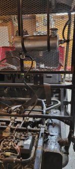

Oh and here's the muffler and stuff (limit of 10 images 🙄)
It's missing a drain plug but the threads are shot so whatever... this thing was seriously designed to be amphibious.
The CVT cover is missing, but it was ducted into the rear bar with its own airfilter as well with the front of the clutch acting as a centrifugal fan

Just find a cheap small car muffler and make a 2 into one header to fit into the muffler.
That's going to be a total PITA and more expensive than just doing duals with a pair of cheap motorcycle silencers. There's enough expense with needing 4 new tires on account of dry rot and bad checking.

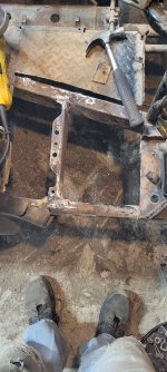

As bad as the driver pan looked its quite solid still so I don't think I'm going to bother with doing the whole cab floor. Besides getting the two 24×24×0.07 sheets needed has an outrageous price and won't even be diamond plate.
I only decided to go ahead and cut out the drivers side all out (battery quit on me I've still got some cutting to do) because it's the worst and it's also the only way to properly patch up the one bad floor brace between the main frame box and outboard frame tube.
Yeah I cut with a Ryobi 18v cordless and grind with a DeWalt 9A
