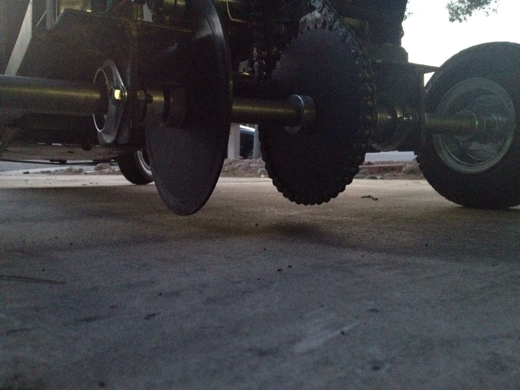

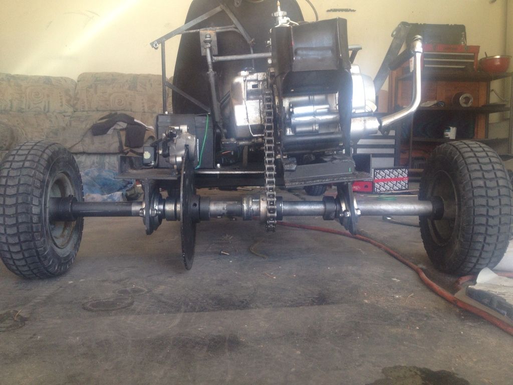

Also got chain fit to length and live axle installed for good. These are my clearances..... Lets hope for best! :)
