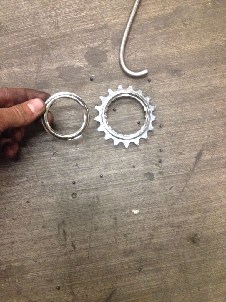

so it was my first time greasing a bearing.... like taking apart and greasing it, not just spraying it...... bad mistake, used to skateboard bearings where there is a plastic coupler that holds all the balls..... not on this sprocket there wasn't....... all balls flew out and yeah, time for a new freewheel :/
