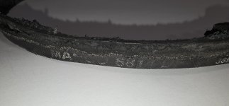

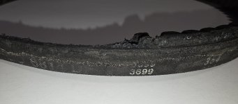

I didn't see anything on it that said 30 or 40 series, it does say Comet industries and the picture is not very good I took it just tonight in the dark, I'll get better pictures of it tomorrow. As for the diameter I'll measure and get back to you.Looking closer at the driver, you have a 40 series.
Okay, so I'm not sure which one is the driven clutch, is it the one that's not attached to the engine, if so that one is just barely under 8" diameter, the other one I measured the circumference and converted that to diameter and it measures 5.73". Now the center shaft measurement from the center of each measures approximately 8.5". Hope this helps.From your pictures, which aren't very good, I can't tell if you have a 30 or a 40 series torque converter. Maybe you already know. The numbers on the used belt mean nothing. Here is what's needed to get the correct belt. 1st, is it a 30 or 40.
2nd, the diameter of the driven clutch, in inches. If it's a 30, it will be either 6 or 7 inches. If it's a 40 it will most likely be 8 inches. Lastly, the distance between the center of the driver ( the crankshaft ) and the center of the driven clutch.
Go Power Sports has a table on their website that tells you exactly which belt you need. Other vendors may also have it. It's all determined by the diameter of the driven clutch and the distance between the two centers.
They don't post a # on them, but you definitely have a 40 series. The belt that you show in a few posts earlier doesn't look even close to correct. A 40 series belt isI didn't see anything on it that said 30 or 40 series, it does say Comet industries and the picture is not very good I took it just tonight in the dark, I'll get better pictures of it tomorrow. As for the diameter I'll measure and get back to you.
From what I can tell on the chart, I need the one with the part number 203784 unless I read this chart incorrectly.Yes, the driven clutch is the one NOT on the engine. The one on the engine is the driver. So you have an 8" driven. The most common size for a 40. When you find the belt table, you will see that the increments from one size to the next are quiet specific on the center to center demention.
Possibly, I was using a flexible sewing tape measure to measure, and the belt that came off measured 33" on the outside of it, worst case it's coming from Amazon free return.In post # 28 you said the center to center demention was approximately 8.5". You ordered a belt that is for a 7-7/8 center to center. Hope your first measurement was wrong.
How would you accurately measure center to center with one shaft in more putting the tape measure at an angle?Outside belt measurement means nothing. Center to center shaft distance is how they are calibrated.
I own multiple tape measures, however in my experience measuring at an angle usually produces a longer measurement than one straight across due to the extended distance, I measured it again and it looks like 8 3/16" but I measured it in the dark again.In post # 30 I tried to explain to you that the increments of center to center were quite specific. There is one for 7-7/8, 8-3/8, and 8-5/8. Do you not own a simple tape measure or hard metal ruler. And know how to read it. A fabric or roll- up sewing tape isn't going to be precise enough. That's why the differences are so closely calibrated. It matters in what works, and what doesn't.
