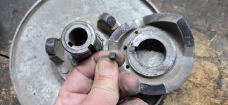

Yea, as WTR says, took some weight off the weights in the driver of a 40 series. The goal was to remove 30g but to go any further, I would have had to buy a new drill bit set as I broke every one up to the size you see in the weights. Few broke off inside the weight. Those were fun to remove. Caused two more to break off inside. Several broken bits and a screaming, sad sounding drill later, worth it! Keeps it in low long enough to smoke the tires on the road.
Describe your drilling process. Did you use cutting fluid? Drill press or hand drill?
What is the material of the weights?
While the process and result sound "fun", I am actually surprised someone does not sell weights of different size/weight to achieve the tunability you have created.

I drilled more holes in my 40 driven like the 30. Gave the spring more tention.
It holds low gear longer and will also light the tires up.
You can see the holes here and the key trying to shear. Lol
I was looking for a little more "hold" in low. My poor red spring cant take anymore tension. I need a yellow in my "further drilled" hole. I really make this engine work for the shift.PXL_20250901_161854640.jpg
