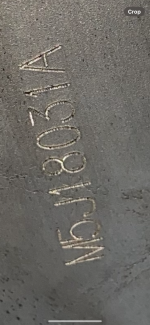

I found this. Also I found a piece that had a cap on it. I tired pilling the cap but the whole piece came off and started leaking like this?

Just wondering where the water is coming from. The hose runs from the top of the head to the air box then to that connector.
That's probably just an airbox drain stub. If it didn't dump a whole lot and there's the right amount of oil in the crankcase still consider confirmed.
Basically a drain tube for airbox condensation moisture from the other tube which is the PCV (positive crank pressure vent)
As for that number you got doesn't tell you anything without what manufacturer to cross reference it with and as I said prior it looks like (never means much) a pre Polaris era Hammerhead (90's)
