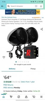

I got these speakers. Has anyone ever used these and are they loud enough? The axle is still on its way and then I can start to build more
