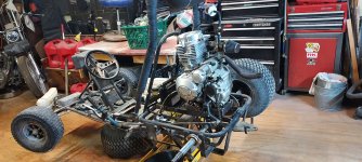

Your better off buying a frame some where. I see old karts that need a ton of work for about $100. Start there. That will save you both time and money.
I have 2 dingo frames I have modified. one has a budget build 301 and the other now has a 250 quad engine 4 speed.
The 301 has a 40 series TC and will do about 40mph and the other I got to about 45 and thought I was gonna eat sh!t and crash. Working on putting front suspension on it.
I'm out in the desert, dirt and rocks are where I thrive.

Thanks! Might I ask what size tires you are running on the 301? And what do you think of the engine?
4,532
3,532
Running the 18" turf savers on both. A larger tire would make for a little more top speed but I prefer the tire spinning.
The 301 was what my cheap arse got when the factory briggs blew. Didn't know much then. I knew I had a 1" output shaft. Had to match that. Could have spent more for the 420.
Do I regret it? Nah. I like the big block torque. I shaved .040 off the head, got a slide bore mikuni for it. Made an exhaust pipe. Modified an adjustable coil bracket. Left the internals stock except for pulling the plastic gov gears and pulled the oil sensor. The stock valve springs will float long before the flywheel will explode.
It's a tire fryer.
