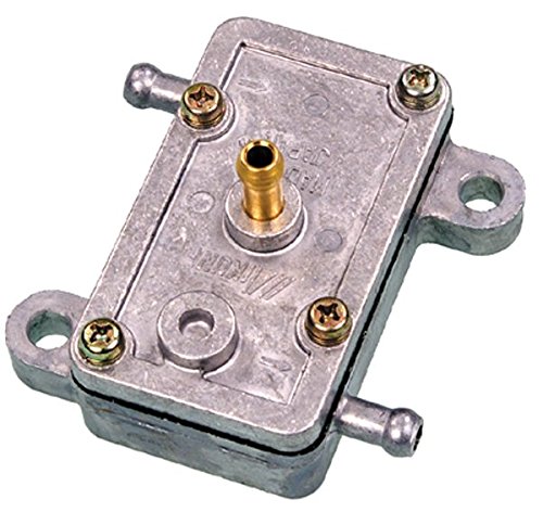

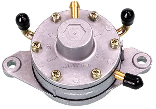

i guess i just need to buy a $20 fuel pump.
---------- Post added at 11:05 AM ---------- Previous post was at 10:23 AM ----------
Also found a dual outlet fuel pump in case i ran a second carb for boost purposes. i probably wont ever need it cause the torque converter is so power-limited.
