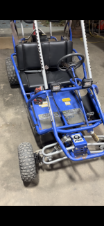

Finally getting close to the finish line
Installed the seat, hooked up the throttle cable and connected the chain.
I GOT TO DO A TEST DRIVE!!!!!!!!!!!!!
the clutch is very sticky, it’s an older one from another kart, I’ve had this one on the shelf for a while, even after a thorough cleaning and adding graphite spray it’s still sticking. I May end up buying a new one so I don’t have to worry about the hassle.
Next on the list is to layout the wiring for the lights and starter switch , and eventually disassemble and paint what was welded and raw metal.
Ill ad a video of everything hooked up that was from tonight.
