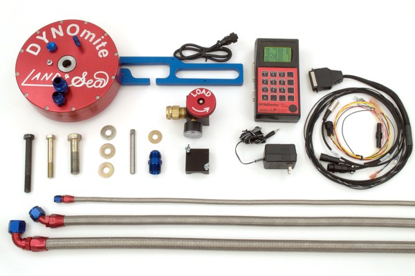

(thinking out loud......)
I guess with that guy... there isnt a need for a known length of bar to be used in the calculations... the torque applied, is what is applied.......
Attach a short ratchet extention to the input of the torque box.... Have a piece of pipe welded with a cheap matching socket to the output for the torque bar.....
Why wouldn't you need to know the length of the bar? A bar 4' long is going to read differently than a bar 1' long due to leverage. You can always say the load cell reads 20 lbs, but at an unknown length the reading is meaningless.

I think he was referring to the other video posted, where the guys had a long bar and a load cell. What you've got probably is easier to use just for a quick check.

You could, in theory, do this with no load cell at all. With the right transducers and algorithms, you could derive all your numbers from the flow and pressure being created by the pump, with the known constants of pump displacement and fluid viscosity.

in theory... yes.
it's far from practical though, just the changes in viscosity alone will ruin the measurement.
And the temperature of the fluid WILL change (thanks to the pressure)
Of course one could generate a lookup table with viscosity at temperature,
but even that has to be an interpolated value at some point which again will be inaccurate.
But then another inaccuracy kicks in (the pulsing behaviour of the pump)
IDK about the number of veins in FHB's pump but chances are the pulses are significant enough to be picked up during measurement.
And we're back to interpolation ...
giant flywheels are a pain to run (from a security standpoint) but in the end, due to the inertia they provide (evening out pulsing and other side effects)
and the more massive they are, the more you can ignore even their bearings and whatnot.
In the end you do not only end up with the much 'simpler' setup, you also have the easiest possible math to calculate the torque provided.
But truth is.. nobody want's to have a giant weight spinning in his workshop, for sure not at the rpms we talk about here...
if it catches on your clothes you'll break some of your bones, your skull even..
if it breaks free of it's fixture it'll create some serious mayhem (and again breaks bones if you get too close)
Sooo fluid pressure measurements is the way to go for DIY... IMHO...
and a load cell does make sense to cancel out most of that guessing and interpolation,
measuring "real" physical torque the old fashioned way (torque bar length and force applied)

I'm not arguing the fact that a load cell simplifies things drastically. Just saying it could be done.
You'd need transducers for pressure, flow, and fluid temperature at the orifice, then the viscosity temperature curves for the fluid, and engine RPM. And some pretty serious real-time calculation capability, which would pretty much mean making your own interface module and writing some rather extensive programming.

Well yes. 10 lbs of force applied at the end of a 12" bar would be 10 lb-ft, but 10 lbs of force applied at the end of a 24" bar would be 20 lb-ft. My point was just that if you don't know the length of the bar, then you can't calculate the torque. But with the gadget he's using, all of that is irrelevant.
