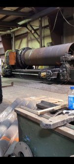

medium sized spinnie thing at work. See large aluminum block in foreground? That and 2 bolts are for tightening flanges. A guy running the smaller 6 inch lathe wasn't laying attention and his middle finger still looks like pac man. Pretty gnarley.got stuck between bed and bar basically split it.
