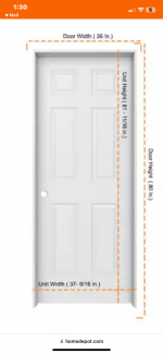

I guess I’m moving forward with the prehung hollow core door. I’ve never hung a door so I should probably learn. I don’t plan on doing any additional framing or drywall. The smallest width of the opening is 37-13/16”. The opening height is roughly 82.5”. The depth of the header with drywall is 4-3/4”
I went with a 36x80” door with jam measurements 37-9/16” wide by 81-11/16” tall and 4-9/16” deep.
So I have 3/4” vertical wiggle room.
Only 1/4” horizontal margin.
Also only 1/4” margin in the depth.
nothing seems to be “too”out of level in the opening. Hopefully everything plum to within 1/4” over 7 feet.
The floor has some slope.
Got some 11/16” x 2-1/2” casing material and also some 11/16” x 11/16” cove Moulding to maybe use on 2 or 3 of the vertical jam to wall “seams”.
The top of both sides will get the 2-1/2” trim.
The living room side will have the hinges and it will be a RH door (hinges on left). The hinges on the side that have the tight wall perpendicular to the closed door. The knob side will get the 2-1/2” trim on the vertical.
Not sure if the 11/16” x 11/16” will fit between the hinges and wall. I think it will work fine.
