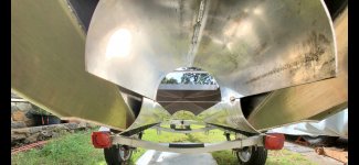

Next obstacle is the prop tunnel. After studying everything i could find on tunnel sterns I figured out how the shape will be and drew the footprint on the hull. Im waiting for a prop thats on backorder to begin this next faze.

It's a mini jet boat hull, but I'm going to use a 12" propeller that will be tucked inside a tunnel to increase efficiency. I'm trying to build a light weight efficient boat that can go long distances and be able to take a beating.
If I can pull this off creeks and rivers turn into roads opening up a lot of areas for exploration.
Wasn't expecting the propeller any time soon, but surprisingly it showed up today.

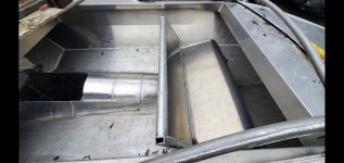

I've really fallen behind with this one, just too many projects. I have made progress over the years. Many time consuming obstacles have been overcome.

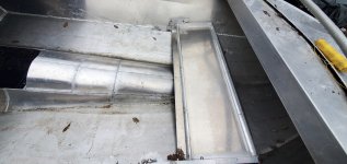

Measured the footprint of the tunnel and cut it out.
Started welding in pieces of the tunnel.
Made a folding seat that sits as low as possible.

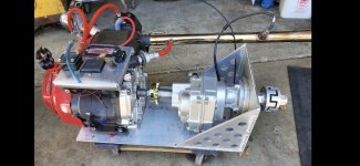

Made a cradle for the engine and transmission. Also made a shaft coupler that adapts the trans to the engine. This was a big obstacle. It took me the better part of a summer to figure out how to make it. It has 6 internal splines on one side, and 1 internal keyway spline on the other. I failed many times making this.
The sprocket is to run an alternator, although I think I'm going to swap it to a belt drive.

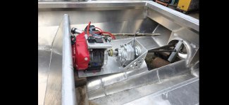

Fitting the engine.
Made a steering wheel mount. The mounting location is adjustable. With one person in the boat I will have it in the middle to balance the boat. With two people, I will slide it over to the left or right. Will get some close up pictures tomorrow if it's not raining.
Today I got the engine mounted, I will get some pics of that as well.

Drilled as many holes as possible to make it lighter. I'm making every piece as light as I can. All bolts are titanium or aluminum which is light weight and more resistant to corrosion than steel.
Here's the engine/transmission shaft coupler.
Got the engine mounted yesterday. I bolted the cradle to the hull so I had the option to remove it if I ever needed to work on the tunnel.
I made this propeller shaft coupler out of titanium. Ive been working with titanium a lot lately, and it's really hard to work with. It beats all my tooling up. It took several hours just to make, and I was surprised it didn't break the threading taps.
Figured out the transmission didn't have a thrust bearing, so I couldn't have the propeller shaft pushing into it. I made this aluminum block to hold a thrust bearing and bolted it to the transmission. Now the propeller shaft can push all it wants.
Made this bearing block for the shaft. It also holds a seal to keep the water out of the boat.
