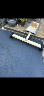

I recently started building my first go kart (fully wooden) I have no prior experience with car parts or any go kart building experience for that matter. And have designed it based off of the classic wooden design with the foot steering. I have already built the frame and front foot steering using a pivot bolt. For the front wheels I used two pillow block bearings with two 5/8 bolts for my tires which had 5/8 bores which are then tightened with a nut. The front steering is fine other than the fact that I need more washers because the front tires are to close to the wood and scrape against it. My real question comes from the rear axle. I have been using Claude ai to help me out with the build but I have come to the part where I want to put the rear wheels and axle on to test out its rolling/ sturdiness. I was originally going to get two more 5/8 bore pneumatic 6-10 inch tires from harbor freight with two more 5/8 pillow block bearings and for the axle use a steel cold rolled pressed rod which would also be 5/8. I brought this up with Claude and they informed me that this wouldn’t work as once I connect the axle sprocket and chain the axle will roll inside the wheels causing the wheels to not roll with the axle or that the power transfer would not work because even though it fits on the tires aren’t locked on. My question is do I need to buy a keyed axle and keyed wheels. They also recommended me a sprocket hub which I can use set screws to screw it down. It’s a good amount of money to spend on something that I don’t know if it will be compatible. I know this post is all over the place but I am just looking for some guidance.

Oh, boy. Where do I start. So many things are wrong with your build. For a push kart it’s great. For a gas powered kart it’s an ankle breaking nightmare.
First let’s start off with your age, how old are you? What tools do you have access to? You may be better off starting with a used frame from Craigslist or bookface market place.
I’m not trying to be mean. Just honest.

I’m basing it off of “Build break repeats” 7 year old video where they build a wooden go kart. I’m 19 and have access to basic tools, but nobody I know or in my family is familiar with any of this kind of stuff so there won’t be any parts that I can make work laying around. I built it out of wood due to the cost I wanted a summer project but didn’t want to spend too much on it because all the money I am making right now I need to put towards paying for school. The frame itself is sturdy, I used a saw to cut around half a pallet and then reinforced it with some plywood.what part are you saying is wrong. I know I’m not an expert by any means but would really like to pursue this without buying a new frame and while using the one I built. I go back for school in less than a month so I atleast want to have an idea of the end result even if I don’t get to finish it

If you plan to build a kart frame for a gas engine, plan on spending well over $500 with tires, wheels, sprockets, brakes, steering components, seat, engine and misc. hardware. All of that comes AFTER you have a solid frame.

I would do a sprocket hub or a one-wheel-peel setup... It’s basically a mini bike drivetrain on the left rear of the kart... but I didn’t watch the video to see what they did.

They used 5/8 bolts on each side, through a couple pieces of 1.5 inch square tubing bolted to each side and bolted to the wood frame. Minibike wheel, band brake on the wheel and a clutch on a Predator 212.
You really should watch the video.

Please post photos of how the frame looks currently and we can go from there. The time crunch you have yourself in really sucks dude. Summer’s over and the kids ‘round here are already back in their chains.

Im not sure what to say. Okay im not being rude at all, you just need to do a LOT more research into this.
Again, not being rude but.. I can tell by the way this contraption is assembled that this whole project is a death waiting to happen. You need to do a lot more studying before you start to assemble anything.
There are incredible forces exerted by anything powered by an engine or motor. Probably 1000x what duct tape and a grade-China bolt will hold.
To make this work properly and safely, youre going to need a budget of some sort, a parts list, and an assembly plan. Plus a lot more knowlege into the subject. You cant just willy-nilly cobble this and that together.

Watch the video. There’s a parts list in it.
Do you have any video links where they show setting one up.
Just do it the way they did it. Do the entire kart the way BBR did it and at 9:40 they show the one-wheel-peel or one wheel drive. Only thing I would change, maybe, is to go to #35 chain as it gives you more sprocket options (more teeth per inch or however you want to say it).
How far away are the front wheels from each other? That track width looks excessive. Just measured my basic Manco two-seater, the track width is about 34” center of wheel to center of wheel. Don’t make the kart (or the wheelbase) super long either or it will handle like a school bus with a 500ft turning circle. 😄
