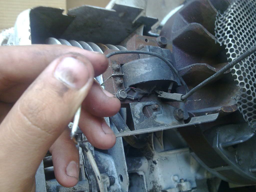

when the cover is on and the spark plug is grounded, it doesnt spark. The problem is connected to the cover somehow.

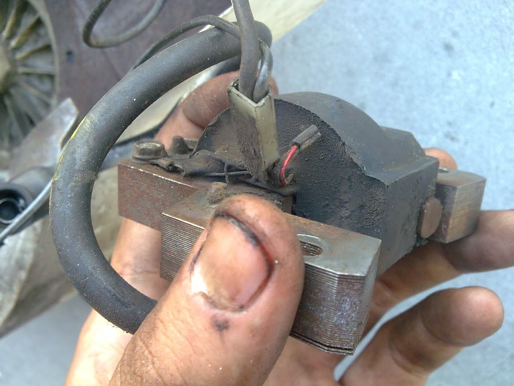

i found a cut in the insulation(related to problem?)
i am not sure where that wire is supposed to be, it is connected to the killswitch.
i was also wondering if i should cut the killswitch for now.

Obviously, something is grounding out when cover is replaced.
Are you sure plug has a good ground when you hold it against the block? Make sure it is a good clean rust free area that you hold the plug against.
Should spark by just rocking flywheel back and forth.
Could check by just checking with you finger. Will give you a jolt, but won't hurt you.

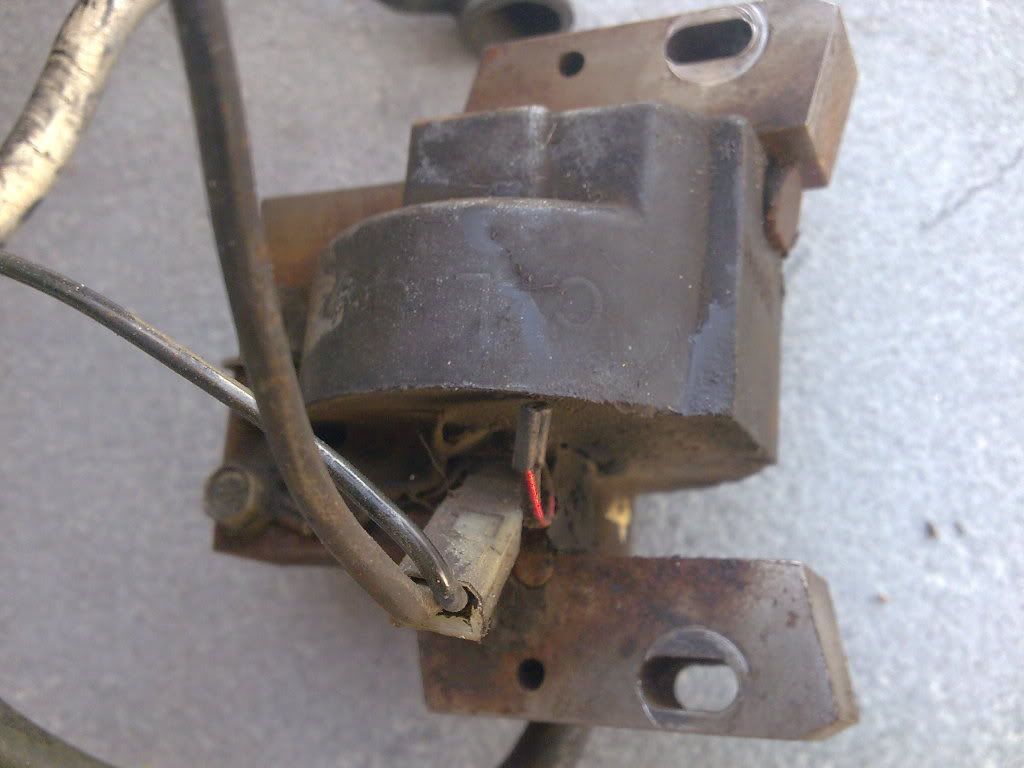

engine without magneto and cover
magneto, iono what where the white wire is supposed to go

That wire going to the kill switch, unplug it, you should have spark. its probably a bad kill switch or the wire is grounding out somewhere.

it does spark when the cover is off. i have tried holding it and i did feel a jolt. when the cover is on however, it is a different story :confused:

Like i said, unplug the mother funkin kill wire, unplug it directly from the coil, then put the cover on. If it sparks then you know either your kill switch, or kill wire was grounding out when it shouldnt.
