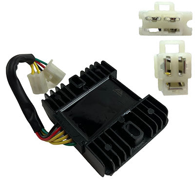

One of the reasons I joined is because I purchased a second hand Dong Fang 4 seater go cart for my 3 grandchildren.
I have had some issues with it but nothing major. First the battery is not being charged. Therefore I want to change the voltage regulator first. I did check all the wiring and replaced the ignition switch. The problem I'm having is to find the correct regulator.
The model is DF200GKD and the vin number is LXDACLAC8H1051449
Attached are pictures of the regulator and tag from the go cart.
If anyone can help me with finding another regulator or trouble shoot the charging system for me It would be deeply appreciated

Try here.
You want a 6 wire 2 plug rectifier.
Then match to what version you have.

Good old china.
Do the colors go to the same pins?
Ive seen entire harnesses wired correctly but the wrong colors. And vice versa.
Follow the wire not the color code so to say.

Yep that's China for ya
The color order of wires on the new reg do not go to the same pins as the old one. I would have to change the order of the wires to match the pins old reg.
I didnt answer your comment, do the colors go to the same pins? Yes the colors on the new one goes to the same pins as the old one. They do not go in the same order on the regulator.

Hope you dont let the smoke out. Its hard to put back in.
Well it worked out perfect Battery charging and Kids are riding. Engine starts and runs awesome. I cant thank you enough for helping and if you ever need anything from me just let me know. Also if you ever make it to Louisiana give me a call. We will show y'all a great time.
