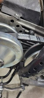

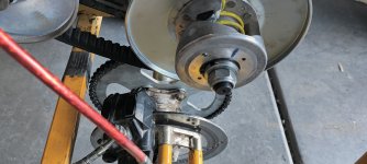

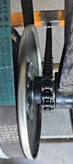

Not sure I have the same exact problem but it seems similar. Here's a summary of what I've done:
- Replaced the sprocket with a 60 tooth sprocket on the axel (#40 chain)
- Replaced the sprocket on the jackshaft with a 15 tooth sprocket (#40 chain). I tried a 10 tooth but it put the chain too close to some bushings I need for spacing the sprocket.
- Replaced the driven pulley with a 40 series Amazon special
- Replaced the driver pulley with a 40 series Amazon special (this did seem to work for a while until it seized and then we were back to this grinding sound)
- Replaced the driver pulley with an original comet 40 series driver (grinding garbage started again here)
- Replaced the belt with an original comet belt
I'm at my wit's end here.
I'm wondering if the #40 isn't strong enough and stretches when it is stressed so that it doesn't line up with the sprocket teeth. As soon as I hit the gas and it is already moving there is no problem.
I did some googling in the Crossfire 150 and it looked like it may have used #50 chain/sprockets. I saw some recommendations for using 520 chain/sprockets too.
Any advice on where to go now?

I put the Go-kart up on jack stands and ran it pretty hard. Didn't notice chain lurch or anything (no noises). I even gave it some resistance with the brake. Seems to only happen when there's a heavier load to move.

Are you really bad at math? You said that you are running a 15 tooth and a 60 tooth. That is 1 : 4. Almost identical to the 10 tooth and 37 tooth, which was
1 : 3.7 . A little better, but not much. You NEED to be 1 : 6. What ever the clearance problem is with the 10 tooth sprocket you need to figure out a way fix it. A 15 X 60 is not going to cut it, especially with the size of your tires. Your gear ratio is just too high. Change the spacer brushing to a smaller outside diameter. There is absolutely no reason a 10 tooth sprocket can't be used on your kart.
2,830
3,818
You are running an ordinary plate style torque converter. It was designed to run with and sold with a 10 tooth sprocket.
atholon
21
I couldn't find anything small enough to provide the space and not have the chain run on top of it. No bushings I could find were that thin with a 3/4" inner diameter. I'm new to this and obviously not a mechanic/fabricator so not sure what other alternative to use.
