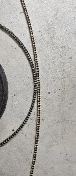

To check chain wear i like to pull the chain at the rear most point. Away from where the chain starts to engage and leave the sprocket.
It should be rather tight. If you can pull the chain up off the teeth its wore out.
Take the chain off and lay it on the ground. If it bends sideways like the one on the left, its wore out.

Thanks, will do. I’ve never seen that before!
