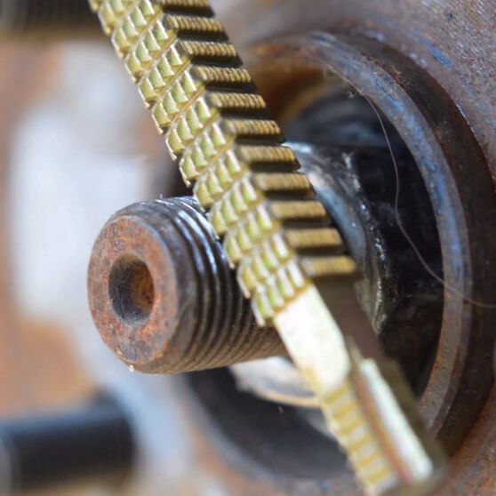

I would get a dye and try and cut new threads. If that doesn't work, you could drill a small hole in the shaft and then use a castle nut and cotter pin to secure the nut

Makes sense. Thanks! I'm kinda slow and I'm not sure what the nut size is because I can't tell if its metric or SAE, but I'm pretty sure its 3/4*14TPI. Only problem being it could also be in mm...
Edit: A single die that fits my needs is at least 70 dollars somehow, apparently. We're gonna go with option b and drill a hole and cotter pin, because that's ridiculous. Are they like diamond tipped to cut the metal or something? Because that's insanely expensive IMO

I am sure you can buy a set of tap and dyes for a couple of bucks at harbour freight etc etc. Take your nut to a hardware store and try thread it on some bolts till you know what thread you need. I am sure you could get a cheap dye somewhere. Heck....someone would do it for you cheaper than that!!!

My dad and I got a Craftsman tap and die set from Sears for probably less than $40.

I thought they wore reasonably priced... my axle is a pretty big thread since it's 3/4 inch diameter, but I'll see if I can fit it on something at lowes or home depot, and then hope that I can fine one of those die sets that includes a 3/4 diameter wit the right pitch/TPI.
Thanks!

We've found that investing in a good tap and die set has been very helpful.
Not just in mechanics, but also for assembling cheap furniture where the threads on the bolts are messed up.
So I would invest in a good tap and die set if I were you.
Never heard of a thread file though.
jandj
1,161
28
Williamsburg, Va
If the threads are really buggered at the end, this will make it a lot easier to start your die straight if the file itself doesn’t clean the threads up.
Different pitch on each side.
Fine thread at one end, coarse at the other.
Come in standard or metric.
Probably even a Whitworth thread file out there somewhere if you work on old British stuff.
