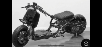

If was was to go thinner and taller, the only thing holding me back at this moment is the way I decided to mount the brake caliper.
I suppose some sort of “Z” bracket off the back of the frame could remedy this.
View attachment 146597View attachment 146598
For comparison sake, all MTB or other bicycles equipped with disc brake have the caliper eyelets set parallel to the dropout by default because the caliper itself handles the offset. Offsetting calipers to line up as needed with washers is not uncommon, and mini bikes with disc brake tend to be done exactly the same way. In fact the most have the same exact caliper ISO mount dimensions as an MTB.
A stepped in offset is not an issue if the material thickness and hardness is adequate, however reducing the axle length and spacing to the dropouts is the safer way to go.
Why?
Simple, Physics dictates that regardless of the material in question; the long the span the greater the deflection, even at rest.
A simple example of this is a 10ft 2x4 compared to a 5ft. The five footer will have nearly no flex on its wider face, where the 10 footer will be very springy.
This is why "Freehubs" took over in high quality bicycle components leaving freewheels for cheap bikes.
A freehub has less overlock, but more importantly the bearings are as far outboard as mechanically possible without interfering with the cog lock ring therefore maximum support.
I digress
The point being the span (more specifically unsupported span) and physics involved; instead of moving the caliper to the rotor, move the rotor to the caliper by using the least amount of spacing you can mechanically get away with

Too low and too wide. It will be hard to ride. It won’t lean as far as you think for turning or swerving. Almost 50 years of riding tell me this. Taller bikes are naturally easier to balance. The bike should feel like a pendulum swinging out of your but for maximum handling and maneuverability.

You're not building a Harley or a 'busa so while physics are unyielding thwre is a factor of preference that dictates low can be negotiated when building from the ground up.
However take caution with avoiding being too long, length tends to be the second biggest detriment to cornering characteristics mostly in terms of turning radius capabilities which lends to cornering characteristics at moderate to high speed.
Honestly all is negotiable if you nail down the steer geometry to work with the frame geometry. It never fails to amaze me how much difference fork length alone can change the temperament between low speed and high speed cornering, of course length affects the caster and trail once the head angle has been established. Moving the front axle as little as half an inch further ahead of the steering axis can change the steer behavior from extremely dangerous to extremely stable.
If your steering whips itself back to center without provocation, your steering geometry is way off, this behavior can rapidly lead to the infamous "death wobble" or "head toss" at speed... the experience I have behind finding that out the hard way is a little messy

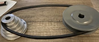

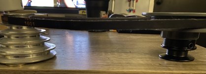

Can’t stop thinking about using a stepped pulley system to build a belt driven transmission.
Might not be great at transferring power efficiently, but the cool factor is there.
