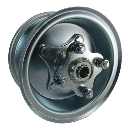

I'd put those aside for another project or keep for spares and seek a wheel and sprocket combo. Something like this where you have the wheel (a two-piece wheel) and a flanged hub ready to take the sprocket of your choice:
Or something like a minibike tire, wheel, sprocket, brake drum and brake assembly sort of all-in-one assembly.
This is essentially the Azusa parts list for a minibike:
These are just examples, I am not suggesting you buy any of it until you work out your blueprints and what your expectations are.
