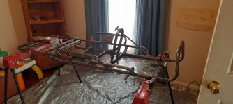

Small update for today. spray bombed it black. I’ll need another can to finish the seat and fog the underside. Took the front tires off the home made kart and stuck them on now I can start adjusting the steering. The paint of course isn’t nice it wasn’t on the first kart either. The first kart is now covered in chain oil and rock chipped it doesn’t matter they get run hard. It painted up just as well as the other one. Now for a quick break and on to the steering. once that is done I’m gonna put the axle in it. Maybe tonight probably not. BFA14060-8D2B-496F-9AEE-C1F8640EA376.jpeg
