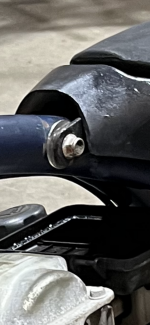

Doing another Murray mini bike build, picked up off the book of faces, and realized that it wasn’t in the best of shape till after the fact of looking at it more closely in the light.
My idea on this one is going to be a solid black with some chrome accents and a headlight ran off the motor.
Upon disassembly I found that some of the bolts and nut had been drilled out , most likely from them being broke or stuck, this was done by previous owner.
First thing where the seat bolts up to the frame had a large washer and different bolt was used , after taking it apart, it was drilled CROOKED to about 5/8 on one side then 7/8 or so on the other, and drilled the entire bolt tube out so I knew I hade to make another one. 2nd the front tire was not the original, a hand truck tire was used in place, 3rd the chain guard/kickstand mount was cut off.
