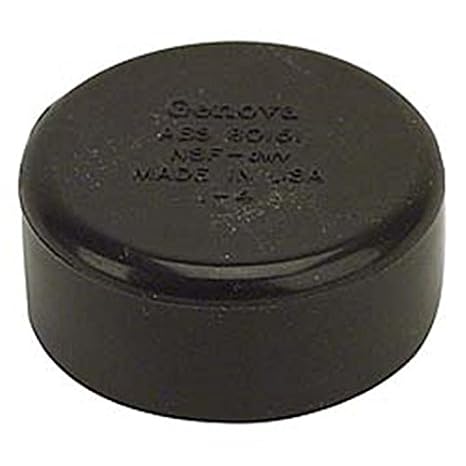

You can alternatively make your own out of a PVC end cap, filed or sanded perfectly flat on the bottom and drilled for the opening and screw holes.

Also do I need to make threads on the outside, or do I just use a hose clamp?

I think you need a cap wide enough to cover the carb throat, the flange and then some, so 2 inch ought to do it. A lot of end caps have molded writing and logos on them so that's why I mentioned sanding it so you'll have a good seal.
Ditch the white PVC and go for snazzy black ABS...

Zoomy: when you get the ABS/PVC end cap, measure the OD (outside diameter) then search the interwebz for a cone air filter which has an inside diameter that is the same, nearly the same but preferably smaller (with a rubber collar).
That will ensure a tight fit to your makeshift adapter. Secure with a hose clamp and there you have it.
