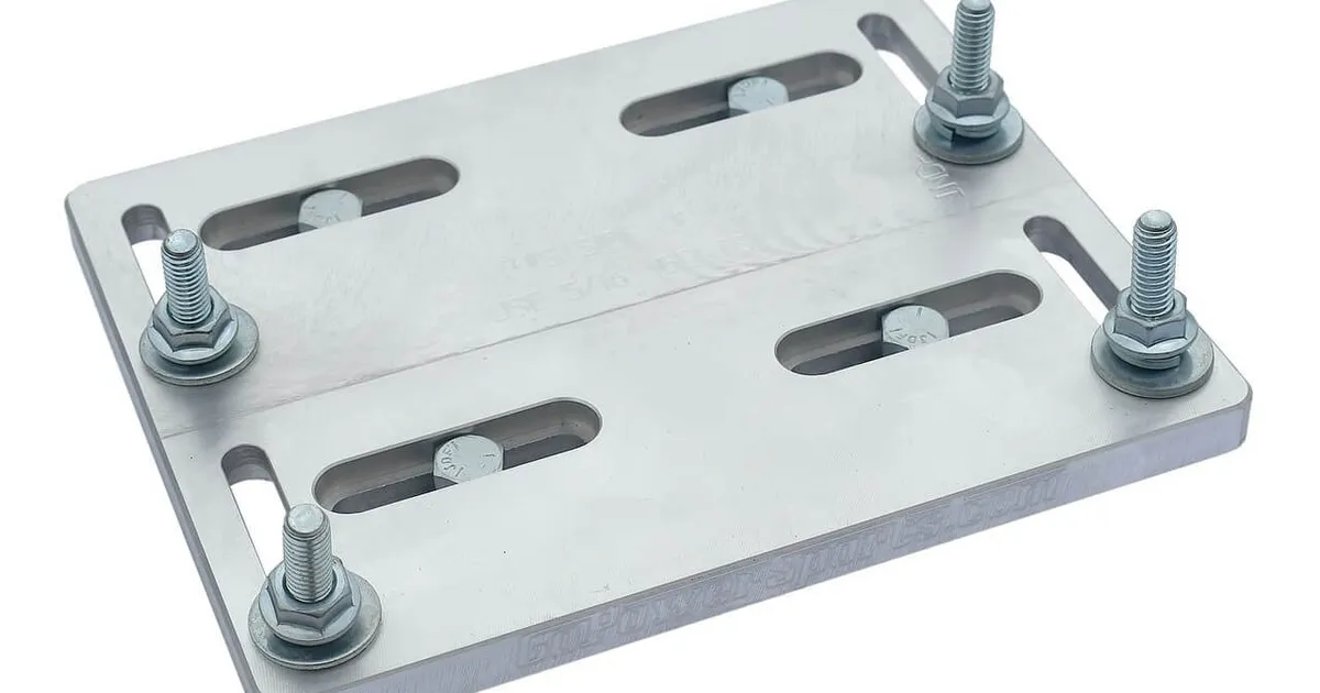

Cartinfun. The plate I am describing bolts down onto your existing engine plate.
Then you bolt your engine to the plate. Yes it has 8 bolts. Four pointed down and four pointed up. If your existing plate is wide enough you might be able to
redrill it, but to have movement for and aft needed to tighten the chain you will have to cut slots, not just drill holes. Of the two I have, I am pretty sure the one
I got from Go Power Sports came with the needed square headed bolts. That way they stick in the milled slots and you aren't fighting with bolts falling or having to hold the other end while tightening. Very well thought out piece.

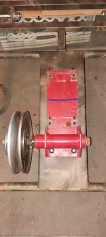

Here is what I am thinking to be able to use this TC
- Cut the mounting plate for the TC between the front set of engine mounting holes and back set (purple line in pic 1).
- Drill new holes in my engine mounting plate on the swing arm to move the engine to left (driver's side) (yellow dots on pic 2).
- Drill new holes in the TC mounting plate for the engine bolts to go through (brown dot in pic 1).
- Use some of the TC plate, cut and drill a spacer so it's the exact thickness needed for the left rear hole of the engine.
- Use the front piece of mounting plate I cut off to use as a spacer for the front two engine mounting holes so the engine is on a flat plane instead of angled.
It seems like the TC mounting plate needs more than two holes and to be sandwiched between the engine and engine mounting plate to keep the TC in place. I dont think the TC will stay in place with just the back two holes.
I was previously thinking about moving the TC over to the right, but that will put the sprocket/chain too close to the engine mounting plate. I had to order a new axle and large sprocket so I should be able to align that with no problem. Just need to make sure it doesn't hit the engine mounting plate.
Thoughts, suggestions? Thanks for your input.

Is this it? Hmm that might work, so I would bolt it through the TC plate and then bolt the engine to it. Right?
2,810
3,779
Yes that is it. Put the TC plate on the existing motor plate in its normal position. Bolt the new aluminum plate through the TC plate and your existing engine plate into the slotted holes ( where the engine has always been sitting ). Now bolt your engine onto the plate to the bolts that are in the slots that are parallel to the axle. You can turn 180 depending on how much side movement is needed. Between the slots in your existing engine plate and the slots in the aluminum plate you will end up with about 3 to 4" of for to aft adjustability . Seeing how you are replacing the axle sprocket position should not be an issue.

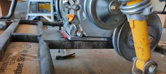

I think I got it. Using the part that Pancho suggested. It's lined up pretty good. I did drill two holes in the TC plate and engine plate to get this other part to mount correctly.
You can see the plate sandwiched between the TC plate and engine.
Thanks for the help Panchothedog

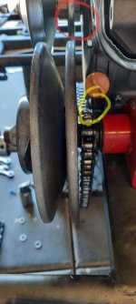

Well, I thought I had it all figured out, until I put the chain on. The chain hits a bolt head on the engine when it goes around the two sprockets (circled with yellow)
I dont get it, the two pulleys line up well. You can barely see the driver pulley on the engine circled in red and the TC pulley in the forefront of the picture. Can I just not use this TC set up with this engine and Kart?

I believe that there is supposed to be a spacer washer between the jackshaft mount and the gear which I am not seeing. I could be wrong, so wait until someone more familiar / knowledgeable chimes in. And I have the old Yerf Dog jackshaft plate that I can measure for you if it helps.
2,810
3,779
Just put a shim ( washer ) on the inside of the small drive sprocket. You will in turn need to shim the driver the same amount as it will move the driven clutch sideways the amount of the thickness of the shim. How much do you need to move it over. Also just a thought, I once had a similar problem. I discovered I was using a #40 chain, which is wider than a #420 chain. Not a lot but it was enough to make the difference. If you are getting into thousandth of a inch, and I bet you are, you could even grind down the bolt head. If it has a washer behind it remove it. How about a Allen head bolt. That could ground down much lower than a standard hex head and still be able to engage a standard key to tighten or remove. This is something I 'm sure you will be able to overcome.
