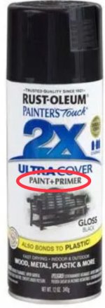

Time for thread revival. @Denny, any paint suggestions? I quite like the look of gloss apple red, but I can only get it in 2X or gimmicky 5 different spray modes. What red do you run? I got Purple Power degreaser, I’m planning on ordering rust oleum sandable red primer, Dawn dish soap for cleaning?
Unless I 'm missing something obvious on the spraycan label, 2X only means they're saying there's 2 times as much Rustoleum paint in the can. I've used only the 2X for that very reason, not trying to build a show kart. BTW: Anybody want to buy a nearly- (but not yet) finished weird big gokart? I've gotten too old.
If not trying to build a show kart, and you want to just save time and effort, coarse sandpaper is your friend. If you want a non-Sherlock-Holmes-magnifying-glass smooth finish real quick, just tear it down hard with some really coarse sandpaper, do it again with smoother enough paper to feather the edges of the old paint, and finish with some pretty mild paper to hide the transitions from old paint to the new paint.
Primer all of it very well (anybody voting for self-etching primer on bare metal?), and spraycan it overall for the finish. You can wet-sand with 600 grit and a garden hose if you want to for a final coat, then final spray and maybe a couple of clearcoats to protect it.
I don't have that kind of patience, much less the energy.

Hey madprofessor, welcome “back”. If I take a little looksie I see a paint+primer on the can. IMG_3223.jpeg
I’ve decided on everything in terms of paint, thanks a ton everybody!
