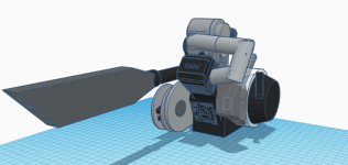

question you know the leaf blowers that are battery powered and look like centrifugal superchargers
1709924873003.png<----- like this one
well I wonder if you put that on the intake and turn it on and a drops of more fuel into the engine will it either
A-blow up
B-BLOW up
C-BLOW UP
D-HP increase
