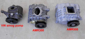

here is a cool image I found
use an amr and note it’s rotation because I do not know if the amr can be driven backwards. Smog pumps driven off the crank are spinning in reverse. Hence why mike clements spun his off the flywheel side to get the pump rotation correct. Many tales of the smog pumps exploding under pressure. And one story of a serious backfire.

$1,500 Porsche smog pumps are the closest to a mini roots blower I have found.AB8ED3B6-76B8-4C59-A835-AA0A466F9C45.jpeg

What was the smog pump mike used? also i cant afford a 1,500$ smog pump the amr300 is 150$. and the one in this photo looks like an actual supercharger
Custom built one off. Not a kit or anything buyable today. Use an amr300 or a smog pump and try your luck with boost. It’s been tried many times before.
