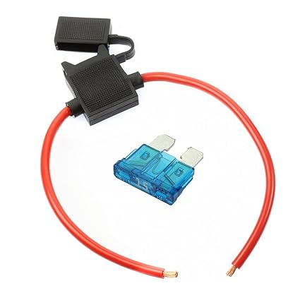

Something else you should do is install two 15-amp inline fuses to protect things in case of a short.
I'd install both fuses at the starter solenoid post along with the positive cable that goes to your battery. Then connect one of the inline fuses to your #4 wire, and connect the other fuse to the wire that's supplying power to your push button start switch.
I'd use 12 or 14 gauge wire to hook up your push button start switch.
ATO fuse holders are available at most any auto parts store:
