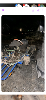

Ok guys here it is the first pic is how I got it I did some trading an got a ttr90 with a bent valve I'm a mechanic for a living so naturally since i got for a old junk pulon pro chain saw i spent a couple bucks new valves i laped in new rings an gaskets an traded it for this cart with a old clone engin that was two weeks ago so its still not much to look at but here it is i plan to do a full restoration

Kart only a mother could love. I'm sure once you're done with it it'll be fast, reliable, and pretty. Every resto starts somewhere. Just remember to take before and afters so you can see how far it's come.
I'll be tuned in for any updates! :popcorn:
1,600
1,075
Now it's clear why a left bound exhaust is problematic. Looks like gobs of room for a fat pipe on the right without doing much more than adding support brackets for it.

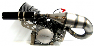

Looks like you have that motor mount welded to the frame, Is that just temporarily tacked? If your gonna build your own motor mount you should clamp it around the 2 frame rails so you can simply loosen the bolts to slide the mount to adjust the chain, like this Yamaha shifter kart mount: 1703081507851.png
