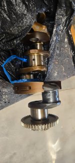

Heres the crank damage on that one.
That crank is toast.

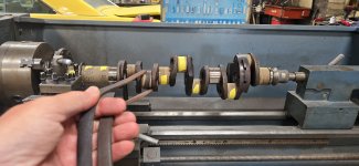

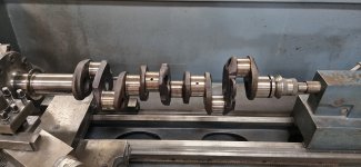

Today is checking this other crank to see if its in spec or not.

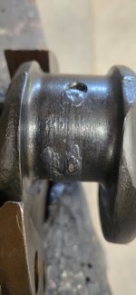

It had spots like this.

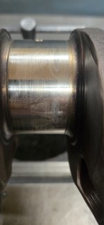

Got it polished out and mic'd everything.
It passes.
