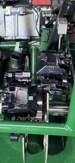

I fired up the spinna thing and made an axle/spool for the back and started to lay out brakes. Everything is just a trial fit.
Looks like it should all work.
Also got the rear suspension plan solidified.
