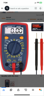

Try a new coil. It’s like $15. Still sounds like fuel bowl not filling fast enough or the coil. Or test the one you have if you have a multi meter with OHM setting.
you suggested the ignition coil when this started when you said the “Stator” was bad, then I suggested it, then I suggested it again, then others suggested it.
If you don’t have digital multi meter, that might be a better use of the $15… but still may end up needing a new coil.
