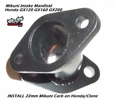

That carb should be fine,
but I'd check the gaskets at least,
maybe find a matching intake manifold, to mount (and seal??) it properly.
something like this:
The way it's mounted directly to the intake doesn't look very airtight to me ;)
'sid
