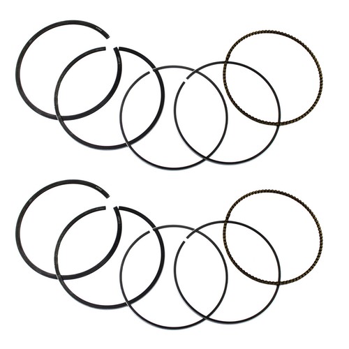

NR Racing called me back today. Said i was searching for 301 rings. The nice lady said they have been having trouble sourcing them and have had several people asking for them too.
I did however finally run across some rings. 80mm x1.2mm
They fit a kohler CH23(?) twin that goes in ride on mowers and small yard tractors.
I let the lady at NR know where I found them and she seemed interested. Maybe they can get some for their other customers.

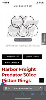

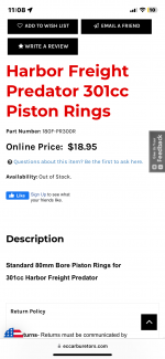

Did we find out what the thickness of standard 301cc rings are. I know the Kohler ones you said were 1.2mm … is that the same as the Predator? Forgive me if you mentioned it before. I know you mentioned 1.2 and 1.5mm or sumthin before.
