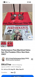

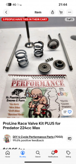

Guys I'm in the middle of installing the engine and I need some help.
I got a set of performance valves from eBay ( see attached pic), and before placing the order I checked if some modifications were needed to the valve body, and the seller said no. While installing the valves I noticed that they didn't fit- the stock one have a 4.9mm stem and the new ones are 5.5mm.
Is it normal? Did I get the wrong parts? Do I need to reem the valve body ?

The early predator engines used valves with 5.5 mm stems. The later ones use valves with 5 mm stems. If you can return for a refund the 5.5's , I would. Reaming out the valve guides is certainly possible, but so is messing them up. Then you need to buy a new head. I don't buy much from E bay, so I can't tell you anything about them. I have purchased 2 or 3 sets of 5 mm stem valves ( the ones you need) from OMB Warehouse, and E C carburaters. Buy the whole set together, as the keepers and retainers for the 5.5's will not fit properly on the smaller stems. Setting the scenario for a complete disaster.
2,925
3,968
After looking at the pictures you posted is another reason I don't like E bay. They don't even bother to tell you the stem size. Anybody selling parts for a predator engine should be completely aware of the 2 different sizes. Also the add says machined valves. What are they made of. The ones you buy from legitimate kart supply shops are Stainless Steel. The kind that won't break with stronger valve springs, or at higher rpm. Look for your hop up parts in the right places.

You probably require 'automotive style' keepers.
You can buy 5.5mm valve guides but these might not fit your head.
Why did you purchase the valves? Upgrades are normally stainless, but unless your going to do a whole lot of other work on the head, I wouldn't bother.
