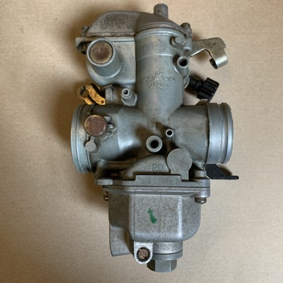

It's got one of these on it, I can guarantee he didn't pay that for it, in fact I may have given it to him!
Added note- 34mm

Not really also I got the carb and it ran out the box just had to adjust the needle
