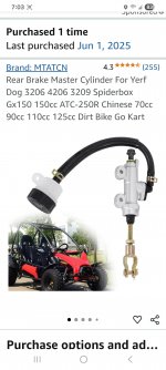

Let me see a picture of the master as it is now. One of those, 2 front, 1 rear output masters?
1,118
1,125
Ok I thought it was a different version but no matter, my response is pretty much the same. I bought that same one for my 4 wheeler.
1. It doesnt work well no matter what I do. If I hop on the pedal on one foot, I can get the wheels to lock for a fraction of a second.
2. I bled them with a vacuum first, then I got some pressure in the line and cracked the banjo bolt. Thats when the bubbles really came out. Obviously you need to be extra cautious doing this, much easier to suck air in this way.
3. You *might* need to adjust the (thrust clip?) and put some preload on it.
