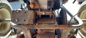

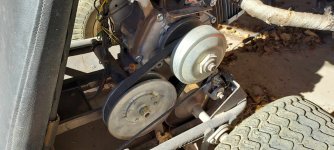

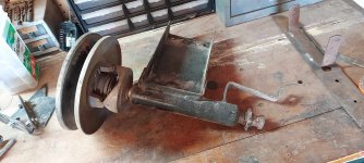

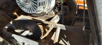

If I remember right. The 30 has a back plate. The 40 doesn't, just 2 pulley halves.
Here is some pics of mine.
This holds the driven and the drive at a fixed distance. Then the whole assembly, with engine slides to tension the chain.
Keep in mind that if your using a 8 or 11hp engine you have a big block and not a small block like the 212. Different mounting plate size. received_332972466274029.jpegreceived_390375266776209.jpegreceived_932721468484776.jpegreceived_255583527422995.jpegreceived_1106983783986417.jpeg
Keep in mind that if your using a 8 or 11hp engine you have a big block and not a small block like the 212. Different mounting plate size. View attachment 147291View attachment 147292View attachment 147293View attachment 147294View attachment 147295
