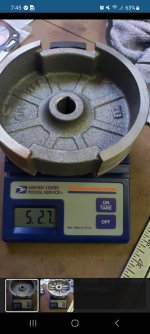

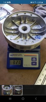

This is that $40 cast aluminum flywheel compared to a stock flywheel.
2 lbs. off the rotating assembly is a HUGE upgrade for these lil turd motors.
This will make an engine get to peak rpm, faster.
Get torque to the tires, faster.
Get weight to move faster, outta the hole.
Get to max mph in a shorter distance.
And not worry about the stock flywheel exploding, while kids are around.

View attachment 137374View attachment 137375
I've been watching some videos and I probably will replace it at some point. It doesn't look as hard to as I originally thought. Right now I need to get 2 carts running dependably.

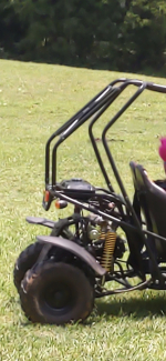

This was my 2nd attempt at a launch. The first time I didn't have the throttle cable tight enough so it wasn't getting enough go juice. I did loosen the chain slightly but it still feels a little snug and likes to creep at idle. It wasn't at initial install but it got tighter. I'll continue to tweak it a little bit and make a better video in daylight.
Huge thanks to BrownStainRacing! Also, thanks to BaconBitRacing, thepartsguy, and everyone else. This is a great community/forum. You guys have been super informative, patient, and most importantly, you took the time to understand my specific situation and gave me detailed information that helped me get this cart going. I almost sold this thing more than once. At this point, I feel like I could set my kids loose on it. I still need to hook up the kill switch (super easy) and re-do the lights (low priority). Not only that, I kinda know what I'm doing now and I'll continue to tweak this cart (and others). I think this'll be a new hobby for me.
I have another video, taken by a friend, that I won't post because it shows my face, and ya know.... internet. But that initial launch did get a little squirrelly. You can't see it, but I had to correct the front wheels because the back end kicked out on the initial launch. Disclaimer - the tires were wet because of the first failed launch.
It's dark and wet out so I'm definitely looking forward to putting some hours on it. Here we go-

I think something's not right with my throttle setup. If I give the wire a little slack it won't pull 100%. Maybe 60%. If I set it tight enough that I can give it 100% throttle, it's idling high from the cable being tight. I think I can add a spring to pull it back and it should idle low enough not to nudge like that.
I found an old picture with the old motor. It's a little different now.
