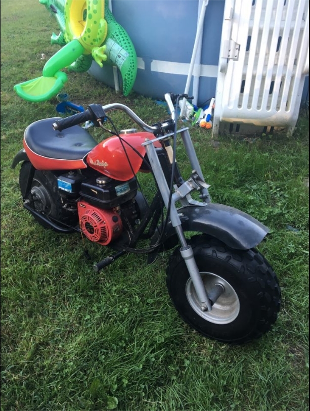

Hey everyone I just recently purchased a Mini Baja bike off of facebook marketplace it isn't perfect as you can see here but shes kept well. Pretty sure shes stock all the way from head to toe. I'm looking to fix up this beauty but I'm a noob when it comes to engines, utv's etc. it currently tops out at like 18 mph and doesn't have much acceleration at all. I have a spare B&S 205cc I am willing to put into it. But I'm wondering what else you guys recommend doing to get this thing stronger? Remember ITS STOCK AS FAR AS I KNOW any help is greatly appreciated.
Things i've currently found wrong / need to fix
  • Pull rope needs to be rewound
  • remove governer
  • Possibly get a torque converter?

Not a bad score--one of the early Warriors too.
I'd leave the engine in it but remove the governor. The governor can also be adjusted for a higher top engine speed, above the industry standard of 3600-3900 revs, but I am not personally familiar with the method.
The other most cost effective mod is to upgrade to a TAV/torque converter as it allows variable speeds all along the powerband.
What is the size and/or horsepower rating of the engine it currently has?

So when you say stronger, how much stronger?
I have a 2014 model Baja Warrior, and did some stuff to it.
Torque converter
Straight pipe (with muffler, dang neighbors!)
K&N style air filter
Re jet to a .036"
She pulls hard, tops out at about 40-42, and sounds great
I started with just a TC, and it would get up to speed, but took longer. The re jet and air flow stuff helps low end a lot, if you gun it from a stop it will stretch your arms back
40 might not sound fast, but once you get up there it feels pretty fast :D
As for the governor, I left mine in, and did the "cord/spring" trick to get it to rev higher. No issues with it at all
You can get a TC on ebay anywhere from $60-80, and there is a full upgrade kit on ebay as well for about $85, but it's for a Predator engine
Speaking of engines, I would just buy a predator, tons of aftermarket and knowledge is abundant on it as well. Look on eBay long enough and you can find one for about $80!
One last thing, the ebay TC will have to be cut to fit on the frame with the engines. I bought one that is made specifically for the Baja and is a bolt on fit, other than adjusting the chain
Hope this helps!
