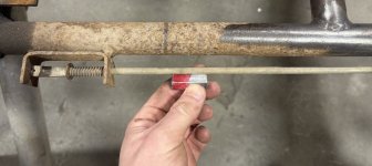

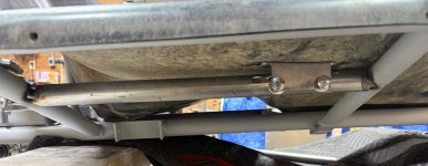

Figured the throttle/brake rods out, I needed to disconnect them from the pedals and then push them up and slide them out of the hole in the bracket, so I will get these cleaned up while everything is apart.
Also I added a brace on the side tubes to help strengthen the frame.

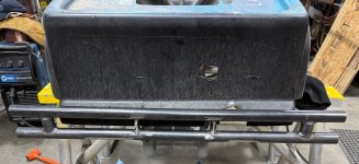

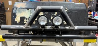

Re-did the bumpers, the yellow and raw metal ones were way to heavy, found some 2” tube that was about 14ga thick, im not a pipe guy, even with the pipe notcher I bought, so it doesn’t look as good because of the serious gaps I had to fill in, but again it’s a go kart, I’ll just cover it with some paint 🫣🫣🫣
I made some brackets with oblong holes at work for adjustability to get things level, marked and drilled the holes and welded the brackets to the bumpers. I ordered some more lights for the front bumper, and waiting for them to come it to mount the tab locations.
I Plan to start doing the body work soon, when we get some not ICE COLD weather, but spring is around the corner so hoping for some good warmer days to come.

Welded the tabs for the lights on and did a little bit of rough sanding, the guy I got the kart from painted all over the old decals, kinda cool there coming to light now, this would have been sooooo cool had it still been 100% together and not busted all up.
