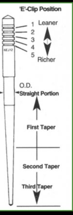

If you believe it’s rich at 1/2 throttle, try lowering the needle position from the center slot to one below it. That should lean out the mix for partial throttle.
Needle positioning is easier to change than needle taper.
1,830
Maybe D5 is responsible for 1/2 throttle?
Ranges from 1.56mm to 2.04mm.
6DP10
1.56mm is most rich.
6FJ6
2.04mm is most lean… at least on the options I show here.
1,830
Tossing away the richest discontinued needle..
Not much variance in D1-D3
D4 range is about 2.1 - 2.4mm
D5 range is about 1.7 - 2.1mm
D6 range is about 1.1- 1.9mm
now totally speaking out my a$$,
6DH4 needle looks interesting.
Without knowing what needle you have now…
6DH4
D4 2.26 mm (2.1 - 2.4 range, mid of range)
D5 1.92 mm (1.7- 2.1 range, on the leaner side)
D6 1.58mm (1.1 - 1.8 range, between mid and lean)
